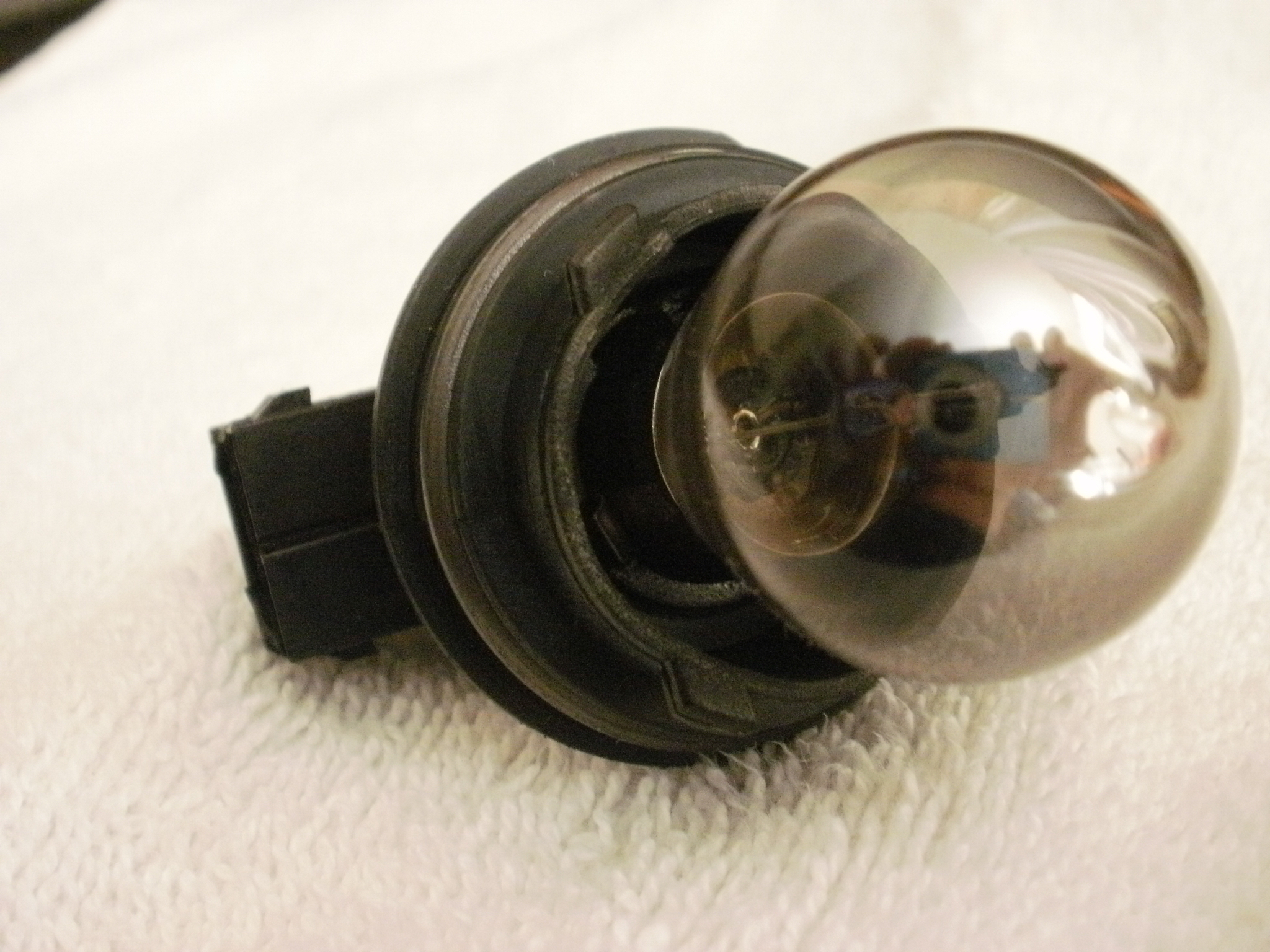

Found out that it is the 3rd eye brake light that is OOC. Anybody know how to remove the bulb from the holder or do they come as one piece?
Tried to push and twist....or simply twist either way.....won't budge. Thanks.
Attachment 27731Attachment 27730
That bulb should come out of the holder... try squirting some WD40 in there...
Yep. Spray, let sit, push down and twist.

Swimming on WD-40. Sit all night long.......and also all day long tomorrow.
