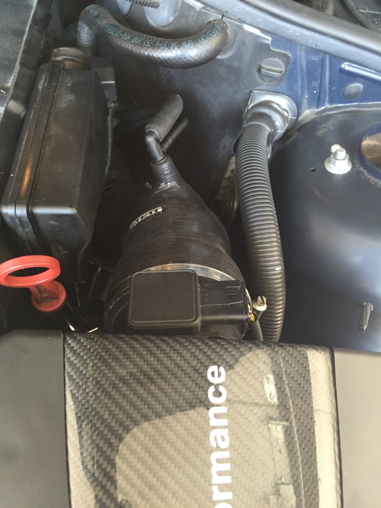

Torn upper and lower boot and broken DISA flap. Not sure what to do about the flap as he needs to go back to school next Tue or Wed. May have to loan him mine.
Still wrestling with the lower boot--tuff spot.

Also cleaned the ICV at 90,700mi.

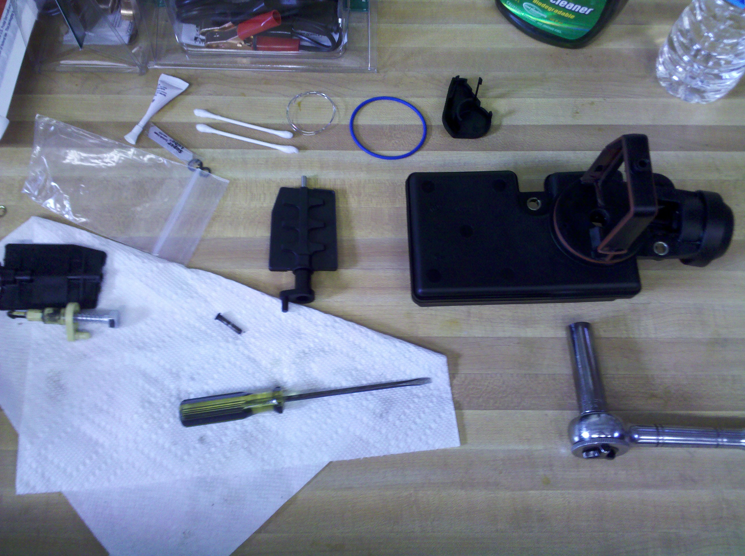

I have a spare DISA valve...if you want, I could over-night it to you as a temporary solution, assuming you want to do the GAS rebuild kit or something like that as a more permanent solution. Say the word and I'll take it tomorrow for shipment Monday.
I borrowed the DISA from my car. All back together with Stett boots. Had to trim the top and bottom of the top boot but looks good.

Those boots were thrashed. As far as the disa, I would get the kit. That's what I will be doing this week.
I did the rebuild on mine; their kit is very easy to put together! Trust me, it's worth it for that price difference; their DISA valve costs over 4x as much as the rebuild!

Thanks BP, I think I'll try that route (and get the cap special). Dane, I can't even test it as the base of the flap ist kaput. I'll leave mine in his car, try to rebuild his and see if it works in my car, then rebuild the one in car when he graduates in May.
FWIW, I had to rebuild my DISA as it was rattling at about 70K miles. Rebuild is very straightforward and saves a bunch of $$. Here is a photo of it in pieces on the bench. Sorry that is the only one that I have of it during the process!

Thanks Brett, I think I will go that route. I hope I don't need any parts from the old unit besides the DISA itself. I think all the bits from the flap got thrown out.
