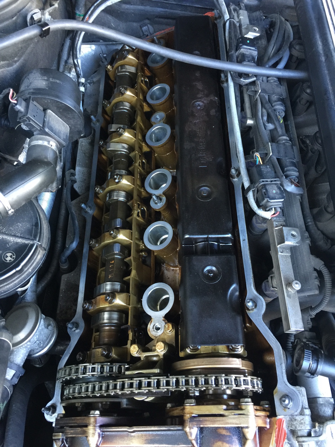

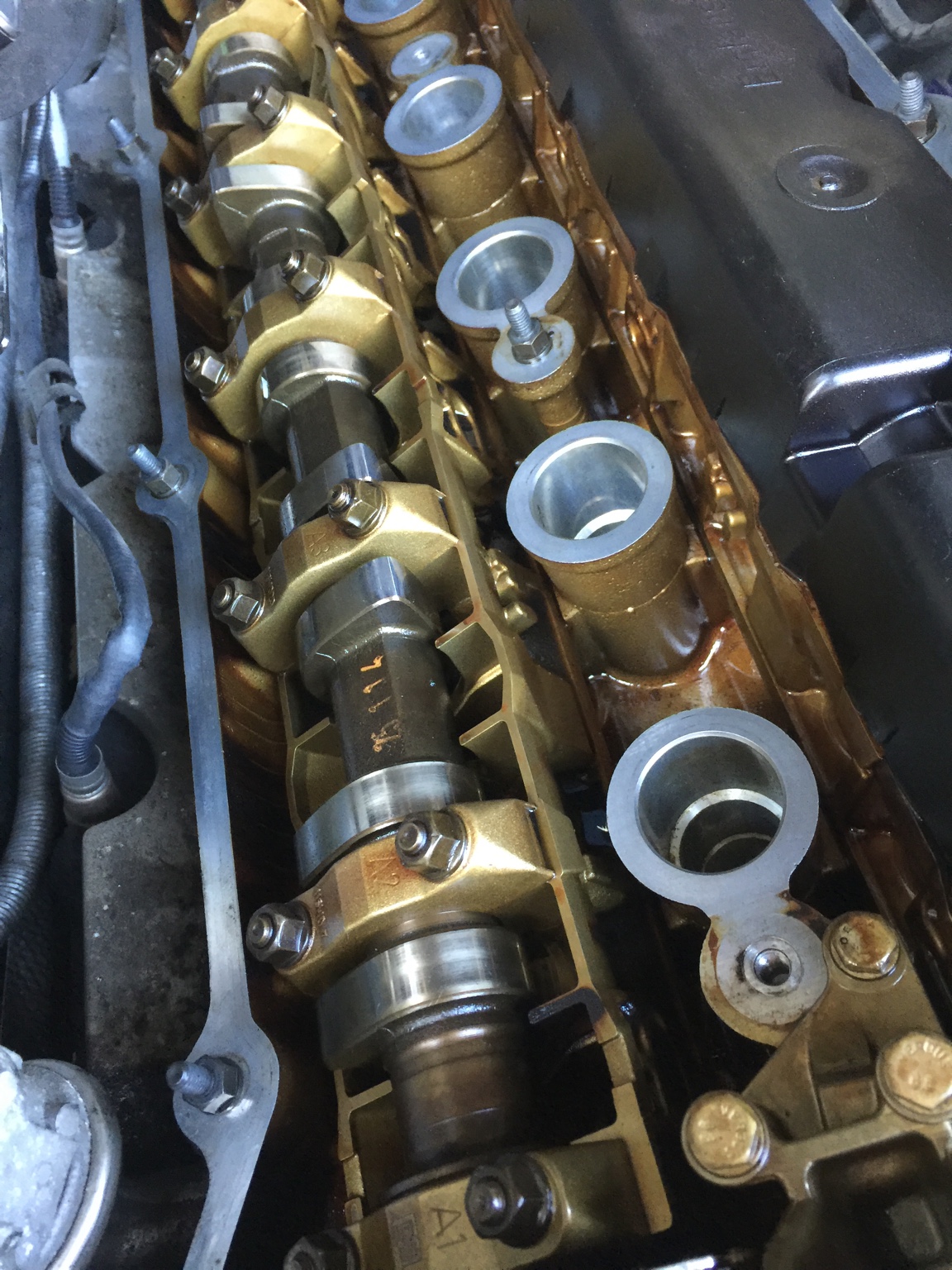

Some success came from yesterday despite my disastrous VCG replacement. I took the door card off, taped down a few of the loose pins/clips and the sound is gone (knock on wood)! Hopefully it doesn't creek up again. On another note, how does my engine look? First time ever seeing her "exposed" hehe. For the miles I have on the car I was pleased to see very minimal sludge/buildup.

As for your engine, looks clean to me! But I've only seen the valve cover off on our cars twice, both times at a mechanics where they were basically cleaning out the top end so they were spotless.
