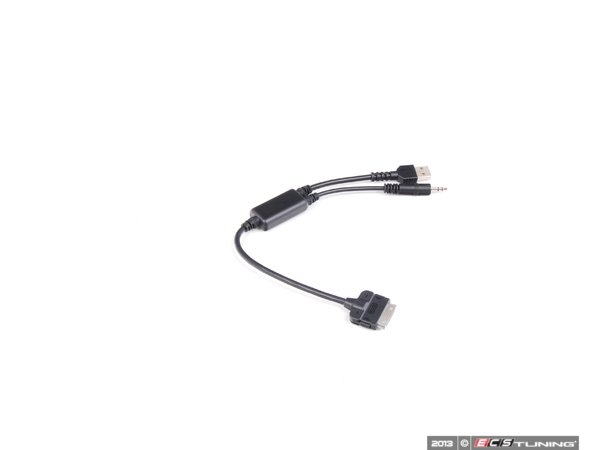

As mentioned in a previous thread, I wanted audio line out to the AUX while be able to charge the phone. I have somewhat a terrible solution at the moment:
BMW iPod Cable:
http://c1552172.r72.cf0.rackcdn.com/403109_x600.jpg
to a Apple Lightning 30-pin Adapter.
http://ecx.images-amazon.com/images/...UL._SX300_.jpg
One odd thing happened when I ended plugging both the USB and the AUX together. The AUX disappeared from the radio modes! It only occurs when the phone is powered. I suspect that when the phone is powered, somehow the AUX line is getting power and shorting out causing the radio to think it's no longer connected.
It almost sounds like there is a ground loop and I need to add in a ground loop isolator. I'll think more about it tomorrow, but I bet that will solve the problem.
