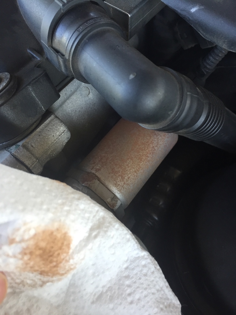

Avoid DrVanos for a bit. They have some quality control issues. I'll post a thread later.
Attachment 25448
Unit is rusting after only 15 months.
They have always done that... They media blast every unit they get. That's what it's from. Just hit those solenoid a with clear coat or silver before installing and you'll be fine
Nobody mentioned it to me before I bought and installed it.
Anyway, DrVanos said they may start doing this themselves soon.
