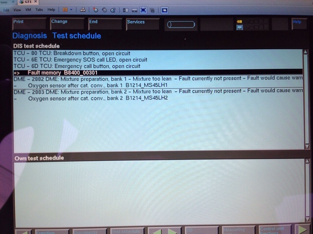

I drive it one day and I get a SES light on. HAHA will have to diagnose.

Attachment 10370
Attachment 10371
After reading into it more on the GT1, I see the lean codes are right after installing the AFE intake. Maybe the drive adaptations need to be reset?
I reset the codes and haven't driven it since. Hopefully that does the trick. I don't feel like finding the problem right now. lol

Minor Update:
Ran into the same codes again after driving again,
P0171/74.
I figured it had to be a vacumm leak since it just happened when I installed the AFE intake. I inspected the boot and low and behold, cracks! It actually is a big hole..
https://lh6.googleusercontent.com/-l...014995_HDR.jpg
I'm thinking of ordering some silicon intake boots so I don't have to see this again. Looks like in 2010, the lower boot was replaced but not the top one.
