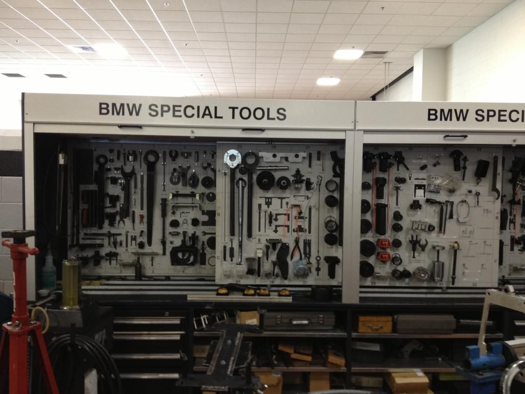

:drool:drool:drool
http://i424.photobucket.com/albums/p...3/IMG_1104.jpg
