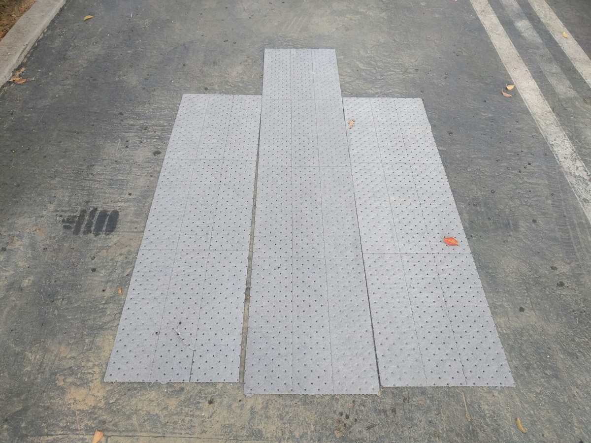

    That is a LOT... are you sure you don't have a m oil leak?
    Pretty sure I don't. Going to double check today at lunch. Unless something broke, I shouldn't have a leak. And if the CCV wqs broken there would be an issue with vacuum. My valve cover is leaking some but I dont think it is that much.
    Going to take the car for a quick spin to bring it back up to temp, then I am going to park over some SPC spill mats to see if there are any drips.

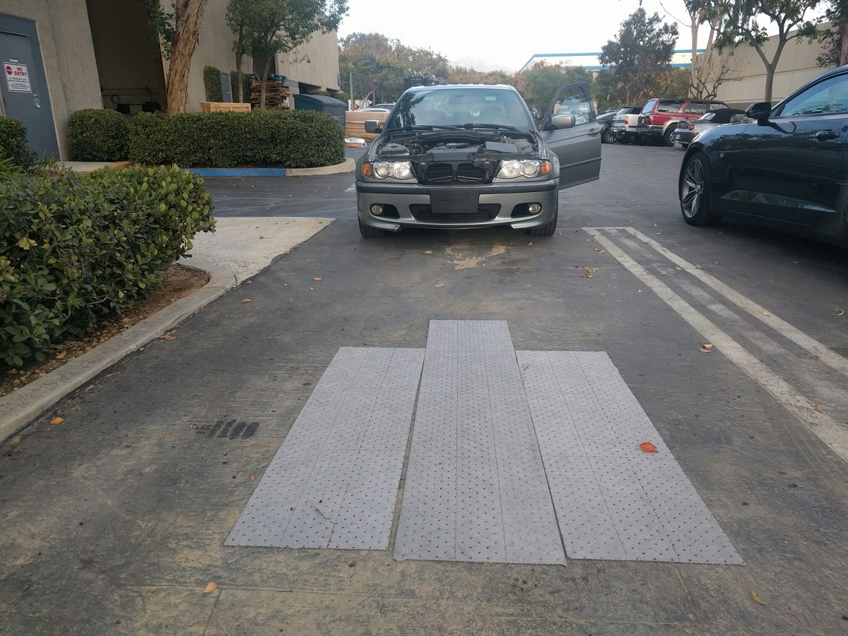

    Parked over some SPC oil spill mats at work today and not a drop on the ground. Was parked motionless from ~9:30am to ~4:00pm. Engine was brought up to temp and then parked over mats. Only some leaves and seeds from the near by landscape.
Size:  429.0 KBName:  image000000 (18).jpg
    [ATTACH]28084[/ATTACH[ATTACH]28085[/ATTACH
    Well all the oil could be contained in the underbody panel. Did you take that off before parking on it?

    Quote Originally Posted by sillieidiot View Post
    LOL, Underbody panel was taken off the car a weekend ago
