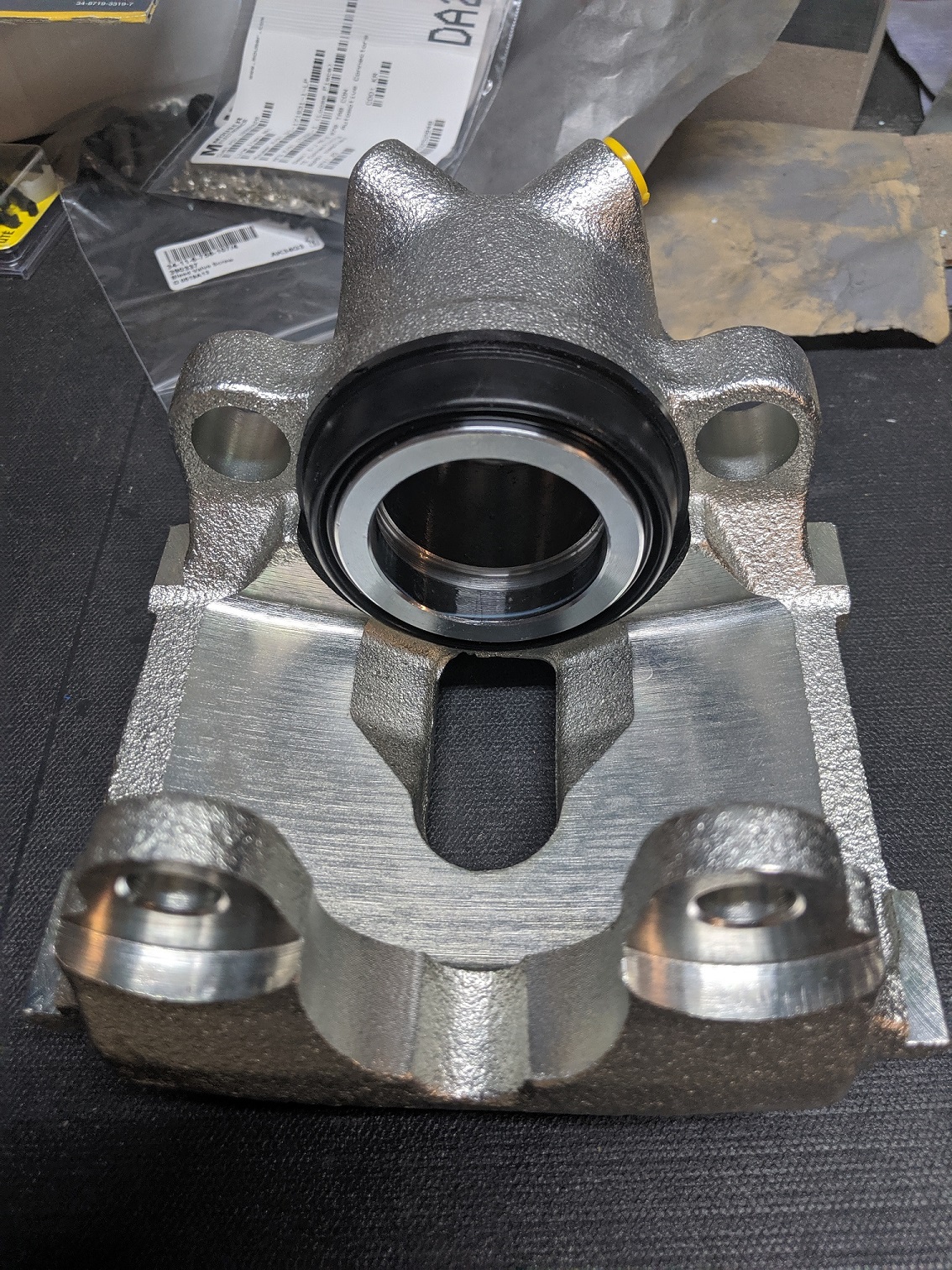

    Ordered it from Rockauto, $105 with tax and shipping. Shipped Thurs, arrived today.
    Sure as sh*t it's a brand new casting, same as OEM 34116765881 without BMW stamp on it.

    Good to know. Does it days where it's manufactured?
    Jul 2018
    Albuquerque
    36
    Yes, it does. China. No big surprise but I have confidence that Hella oversees the quality aspect of their products manufactured by their partners
