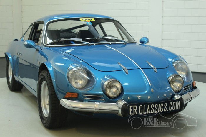

    I'm French, a little biased toward the old (and the new) Alpine Renault

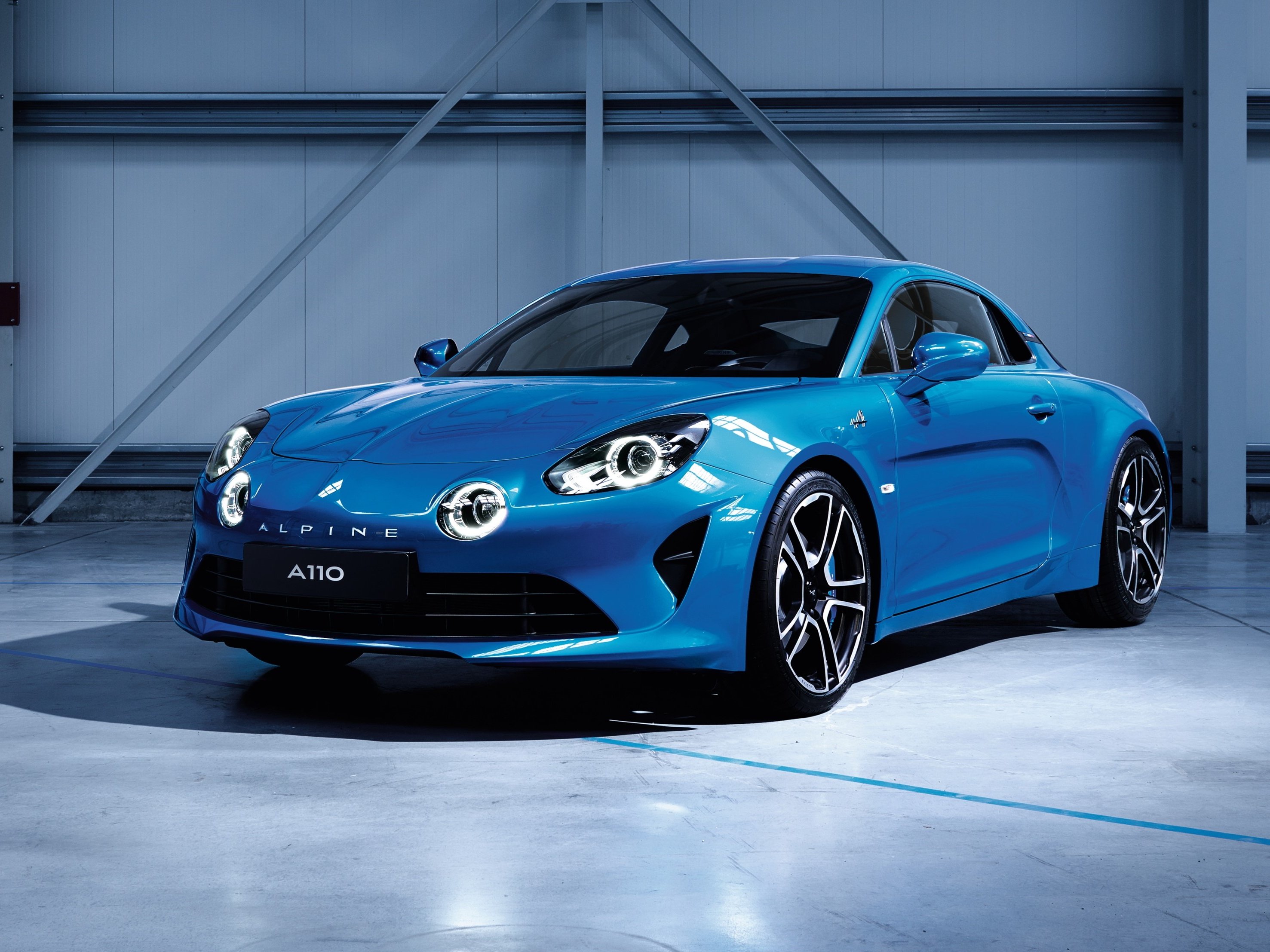

    The new A110 is one of a handful of modern cars I actually want:

    If they came in a stick it would be high on my list. The original A110 is one of my all time favorite cars but I don't think my six foot frame would fit in one.
