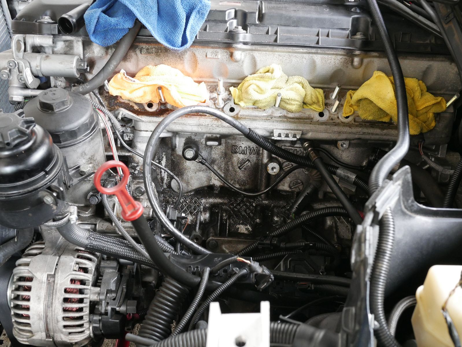

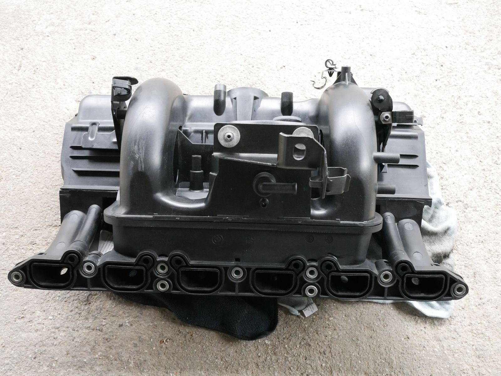

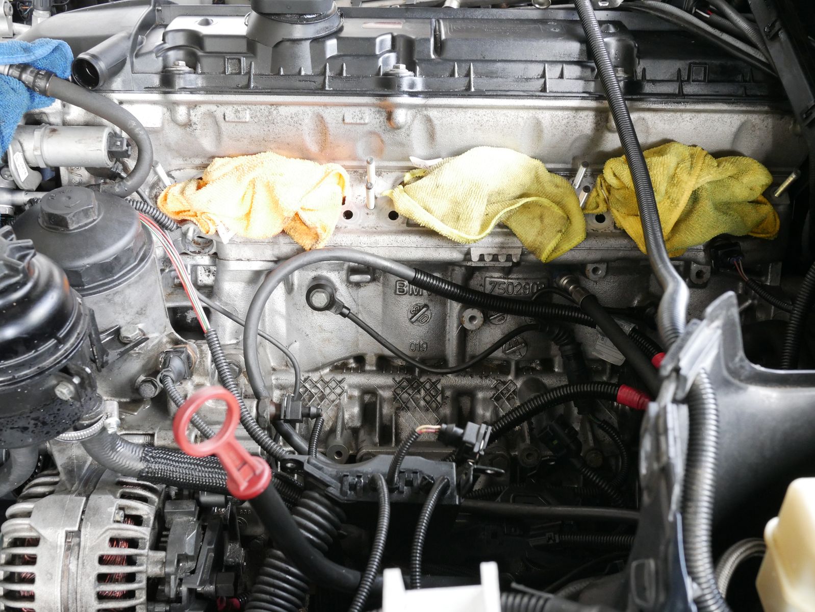

    Haven't shared any updates in a while. The car is doing well, started right up after a 5 month winter break (first one in its life being a southern car from the US). I was surprised that the gas was still good after all that time.

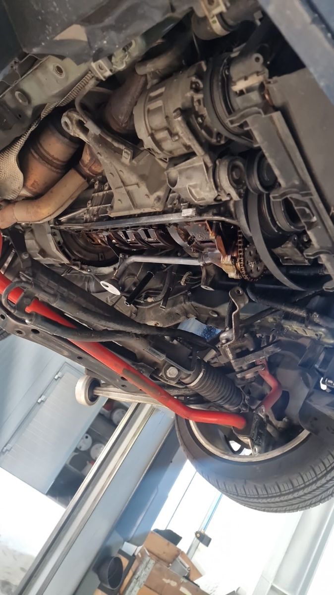

    I barely drive it here so I hadn't done anything to it in almost a year (apart from getting it ready for T?V). I drive maybe once a week, at most. A couple weeks ago I decided to finally install the Achilles oil pump. A local guy from the German forums owns a shop and gave me a good price on the install. He said he can remove the oil pan in 45 minutes so I took him up on that. Also had a new oil pickup tube and oil pan gasket installed at the same time.
    Soon after, the expansion tank started cracking. I was somewhat surprised given that I rock the 1.2 bar cap, but maybe a slow crack instead of an explosion is what I was able to get out of it. Either way I had to also replace the heater pipes before I could bleed the system, so the small expansion tank job became a weeks long manifold removal and "while I'm in there" project.
    Some of the things I did:
    - Cleaned the block, engine bay, and underside of the engine/tray/subframe
    - Ultrasonic cleaning of the manifold
    - New heater pipes and rubber hoses
    - New vacuum lines
    - New vacuum caps and added a cap for the exhaust valve since I have a ZHP exhaust now
    - New suction pump and hoses
    - New gaskets and o-rings where needed

    All the vacuum caps were split and the exhaust valve vacuum line was ruptured, so I must have been driving around with vacuum leaks for years because holy smokes this thing pulls past 4.5k now like never before.
    Pulling off the manifold was NOT fun, I'm actually glad I did the CCV with the manifold on back when I had to replace it. And as a bonus I also added the M3 fuel baffle.
