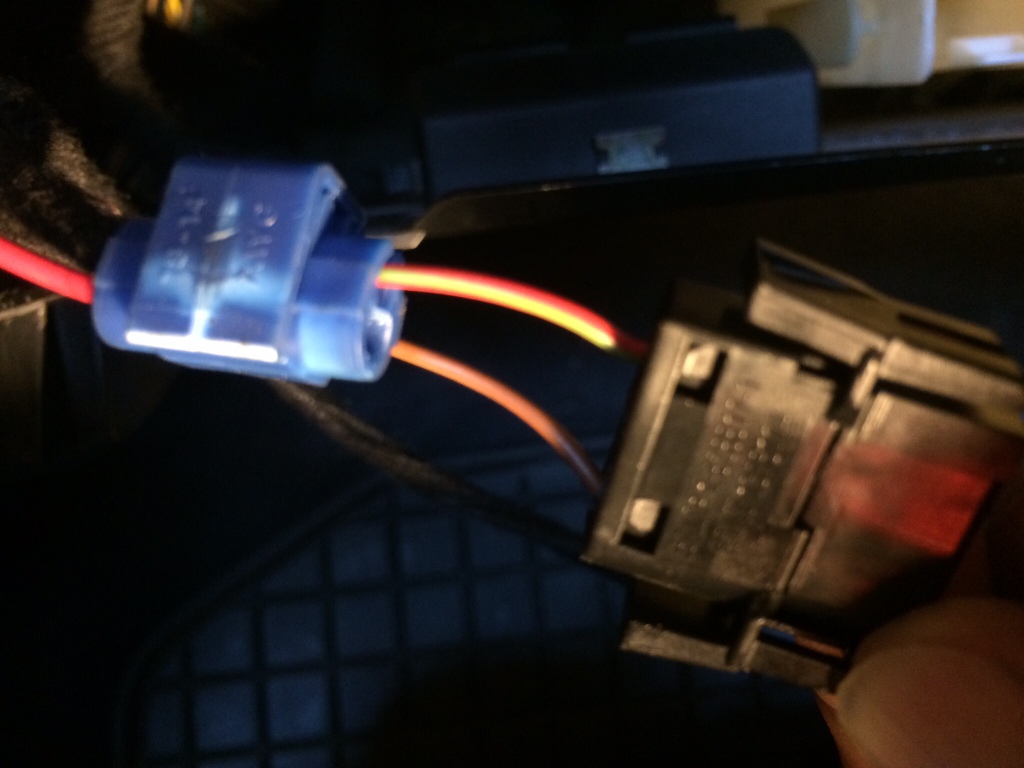

    First, there is a correction on the power source. The wire is red/green.

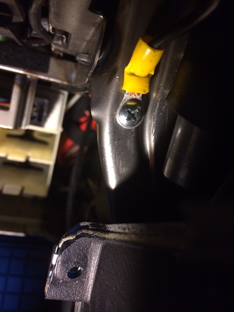

    Ground, right side, near the body of the car. Use a small drill bit and the a self threading sheet metal screw.

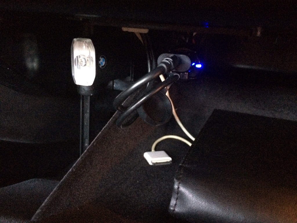

    New cig lighter in glove box. It has a low profile 2 USB charger installed. Bluetooth adaptor is in top slot. That is a standard audio cable coming out of it that goes to my aux input. The second is a standard USB to Lighting cable.

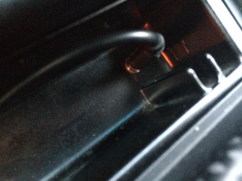

    Audio cable going into aux input. Aux input was installed in ashtray by one of the previous owners. I left it there in case I was to connect another source. It is a nice clean install spot. Name:  ImageUploadedByTapatalk1411958321.057884.jpg

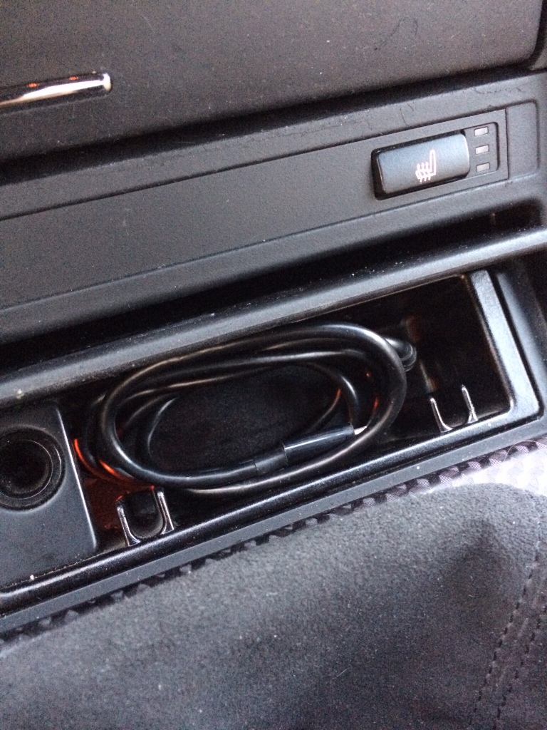

    Everything fits nicely in the ashtray.
