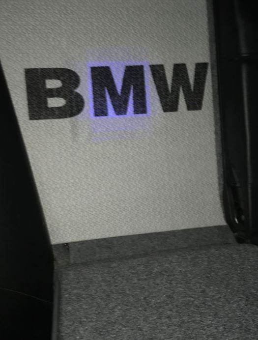

    In order enjoy more bass, I found use for the car cover bag at the rear fold down seat.
    My Z doesn't have the built-in ski bag in the chassis. Not sure if that was an option on these cars.
    We fabricated that with a standard MDF cheese board, amp cloth, and some spray adhesive.

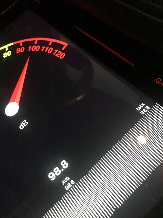

    I'm hitting 99db, which is next to perfect for this size cabin and the mileage on my eardrums.
