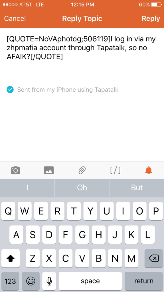

When I am typing a reply I see 4 options. Starting from the left, when I use the first 2 I get a dialog box saying I need a Tapatalk account, option 3 is what I use to attach pics as it takes me to the album on my phone but it shows only pics not videos. The last option in square brackets is for external links I believe... so which one do you use to upload videos?
