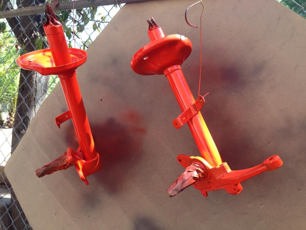

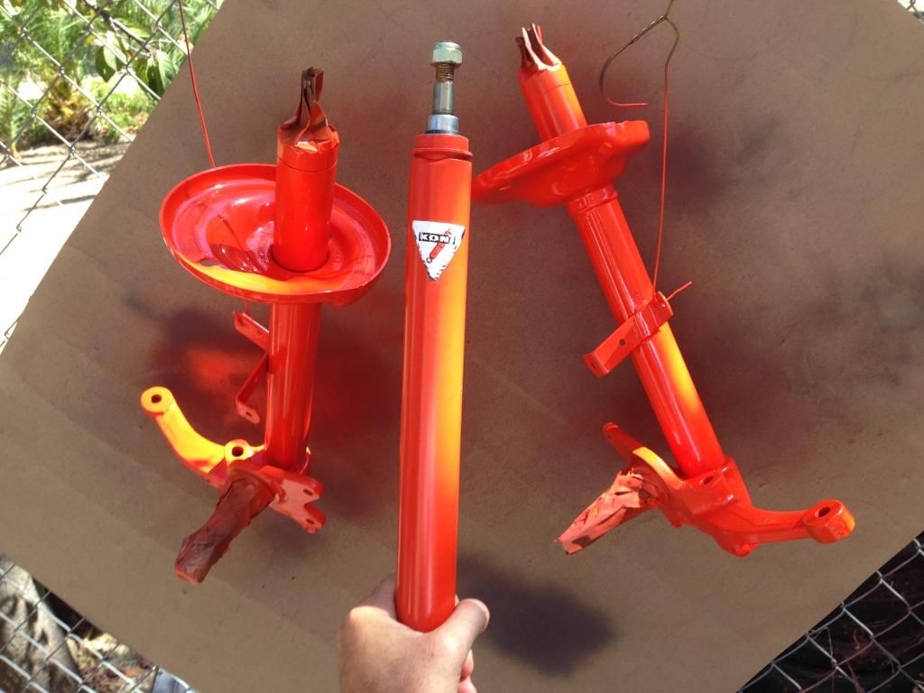

My plan for this weekend is hopefully doing 323 brake conversion. I merely need to:
*paint strut tubes and trailing arms

Step 1 complete
http://i29.photobucket.com/albums/c2...A64209B198.jpg
What are you up to?
Front suspension and brakes

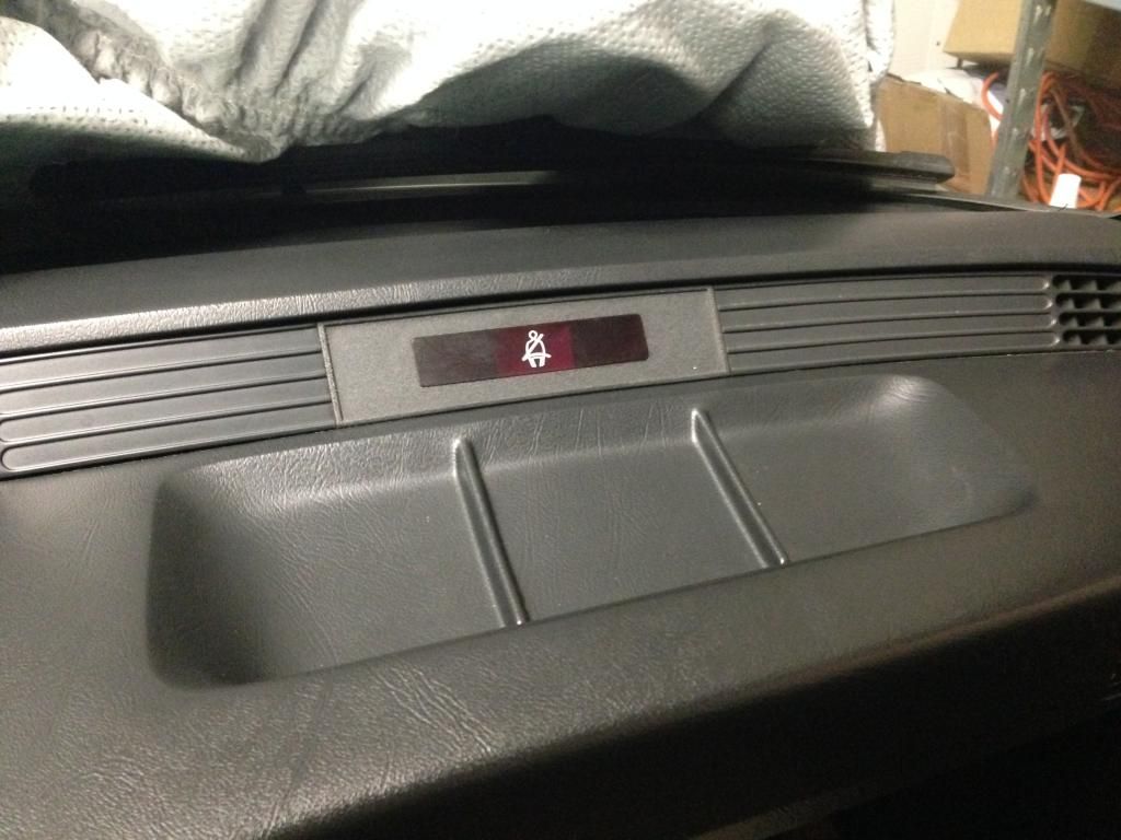

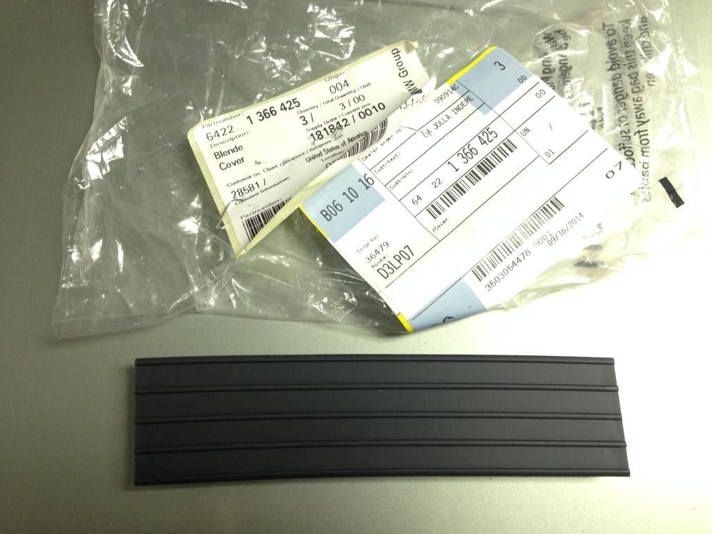

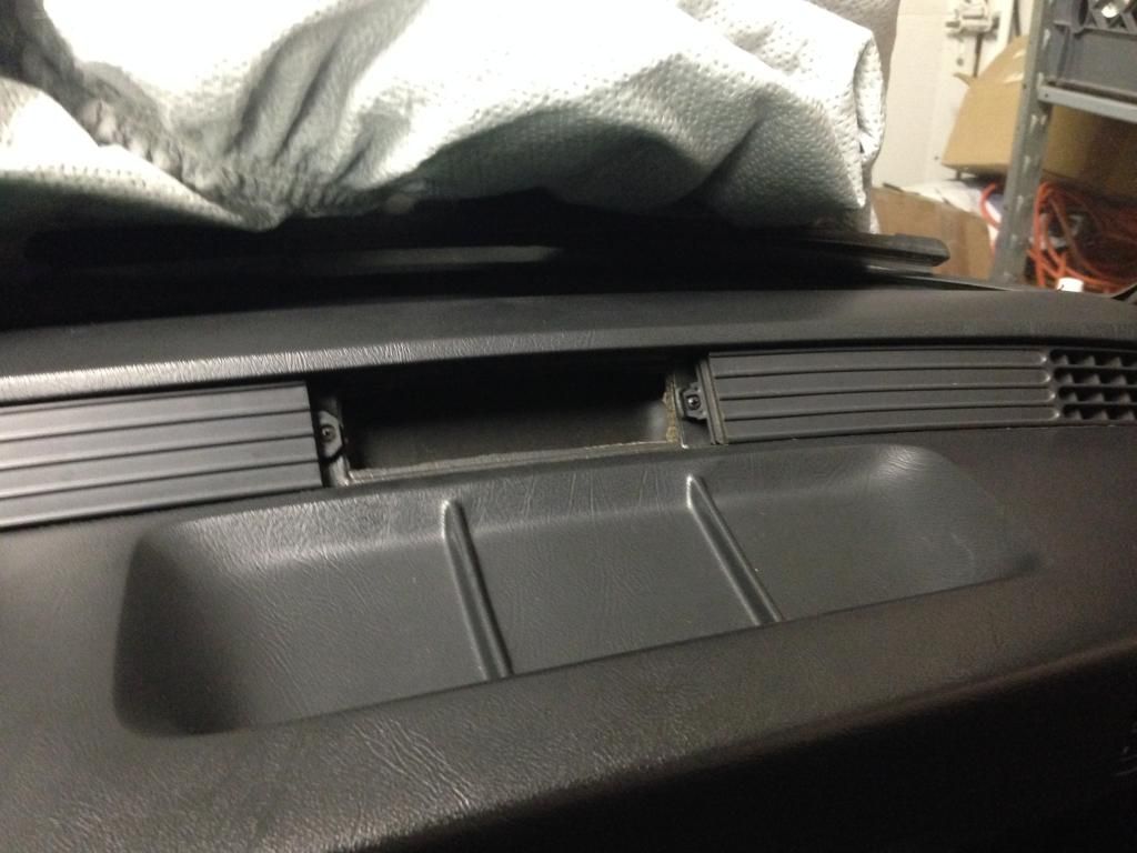

One more checkmark on that euro spec list...
http://i29.photobucket.com/albums/c2...B0B015F821.jpg
http://i29.photobucket.com/albums/c2...AA63337B05.jpg

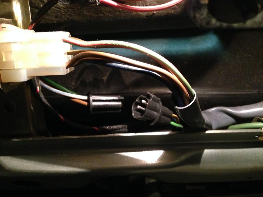

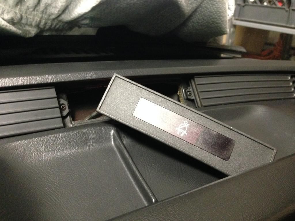

Remember to disconnect it in the glovebox

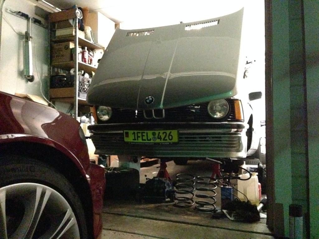

Updates since the last post

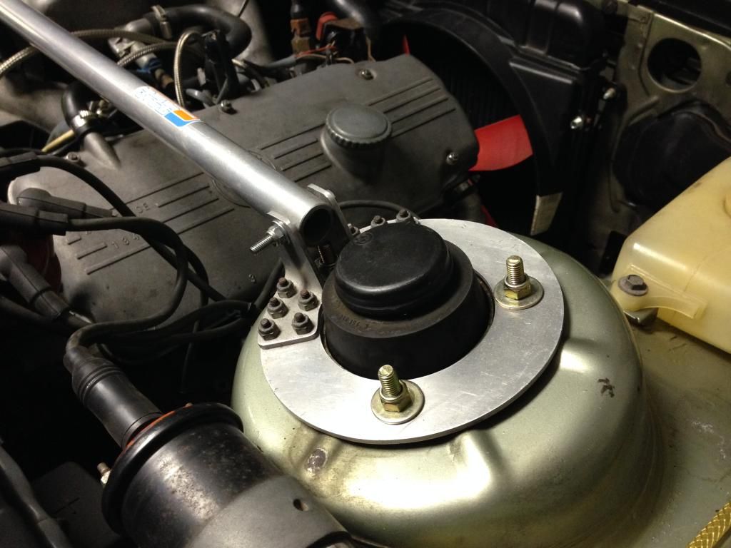

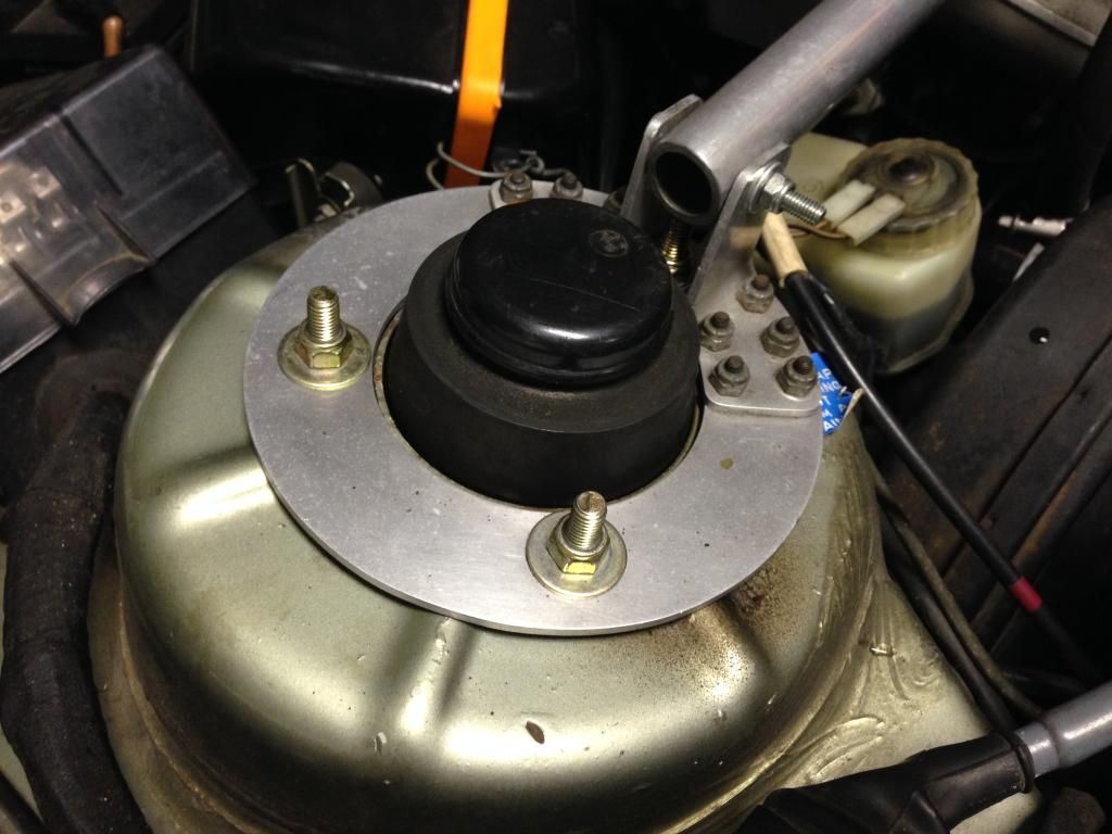

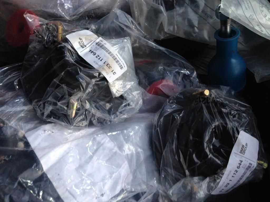

OE 2002 upper strut mount (it has longer studs)
http://i29.photobucket.com/albums/c2...6CCC563D65.jpg
http://i29.photobucket.com/albums/c2...2B0A03C172.jpg

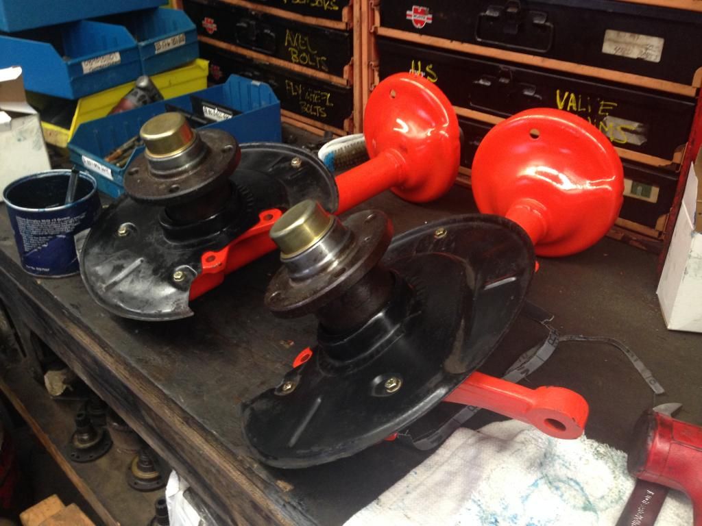

New wheel bearings
http://i29.photobucket.com/albums/c2...1858C91B4B.jpg
ST springs transferred, Koni's installed, new OE bump stops & dust covers, new upper and lower thin spring pads from E9.
http://i29.photobucket.com/albums/c2...8A6AD05729.jpg
http://i29.photobucket.com/albums/c2...D5194CBF55.jpg

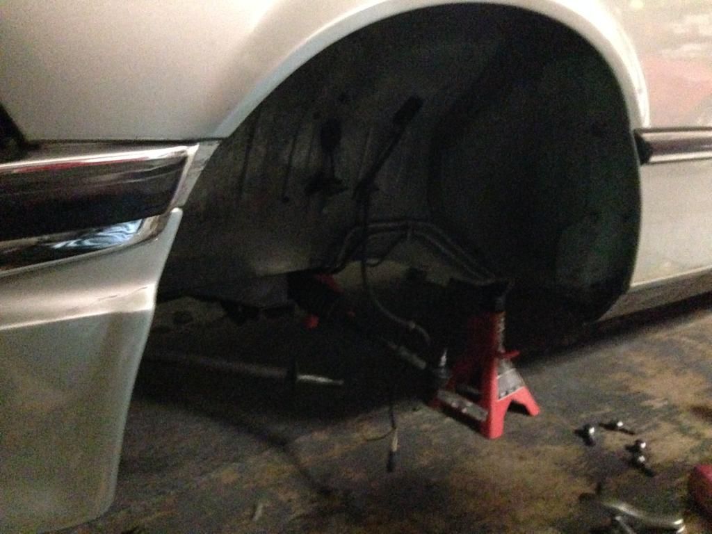

323 brakes installed
http://i29.photobucket.com/albums/c2...6E0906B0C8.jpg
stainless front lines
http://i29.photobucket.com/albums/c2...A8B1BBE168.jpg
http://i29.photobucket.com/albums/c2...29E5CD97_1.jpg
Notice the long studs
http://i29.photobucket.com/albums/c2...9A1602C97D.jpg
http://i29.photobucket.com/albums/c2...9894A49E0E.jpg
http://i29.photobucket.com/albums/c2...EB3FAEE163.jpg

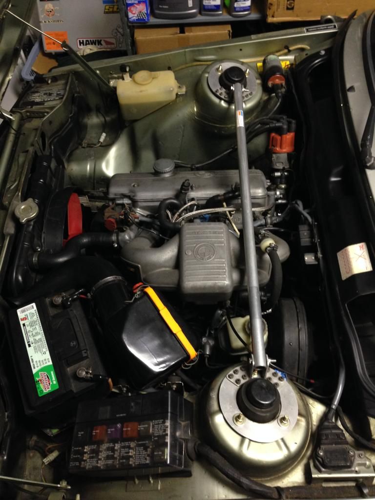

Done
http://i29.photobucket.com/albums/c2...411163D8C6.jpg

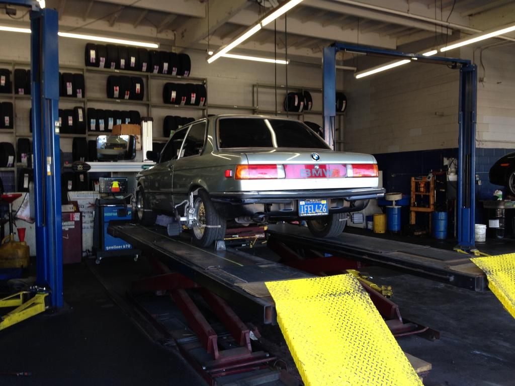

Alignment
http://i29.photobucket.com/albums/c2...9EB9BAA059.jpg

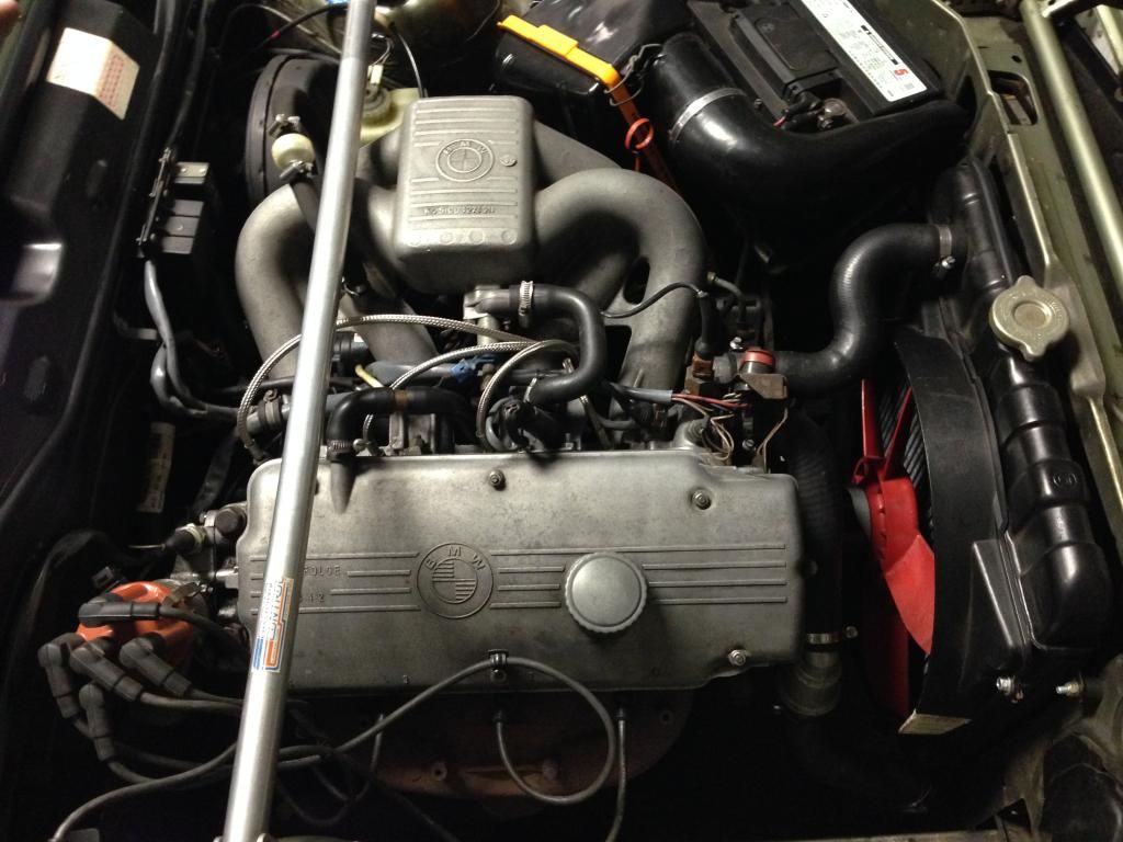

E30 block torn down
http://i29.photobucket.com/albums/c2...4F4BE65B9D.jpg
Waiting on CP pistons and need to locate a 2L crank. Technically I could just use the one I have for the 02 engine but I would rather not. Once the pistons arrive I can get the block hot tanked and bored out to match.

JP. Who's doing the block work? Do the CP pistons need a special coating?
If you're not familiar with US Chrome, they will bore the cylinders to whatever spec you want and coat the walls with a NikaSil equivalent for $125 a cylinder.
That's where I'm sending my Porsche block to be overbored 4mm and recoated.
As for the suspension, that shit is whack. I can't imagine why they left the 2002 set up in favor of this.
Thanks John!
Justin, I'm having the block bored 1mm. I don't know if the pistons are coated, Carl's buddy in Chicago is who built an engine like this. We're having him send us a set of the same ones he used. I'm basically just copying Ben's setup. Once I get it installed Carl will probably have the guys from Miller make me a custom war chip... I'll probably have to take it up to LA to be dyno tuned
That sounds good. If it has been done before then no worries. Some pistons need to be coated and some don't. It depends if it gets sleeved with a steel wall. A 1 mm over bore shouldn't cause problems with cylinder strength. My concern is that the rings will mar the newly surfaced walls if the coating isn't there. Let me know how it goes!
