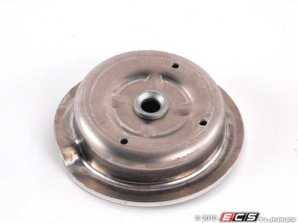

http://c1552172.r72.cf0.rackcdn.com/128936_x600.jpg
http://www.ecstuning.com/ES50296/
Could this part be the cause of a serious "pirate ship" clunking when braking ? It's about the only thing I didn't replace when I changed out my struts for OEM. If not this, what else ? Entire front end is new apart from sway bar bushings.
Yes - twice. Had Homelink added to my M3-style oval mirror in my Z4MC. Super-clean job, if not cheap. After I bought my ZHP I found a Homelink mirror on Ebay (convertibles had Homelink on the mirror, coupes/sedans had the kit for putting it in the overhead console). It had a bubble (and was priced appropriately) so I sent it to Scott @ radar-mirror for his $99 repair. 1-day turnaround, perfect results. The guy does great work and is FAST.
That is the spring seat and bottom bushing. On the other side is where the strut bearing is located. The spring seat itself shouldn't clunk unless the spring was not seated properly, more commonly its a strut bushing that clunks (did you replace the bearings?). A visual inspection should determine if the spring was installed properly.
